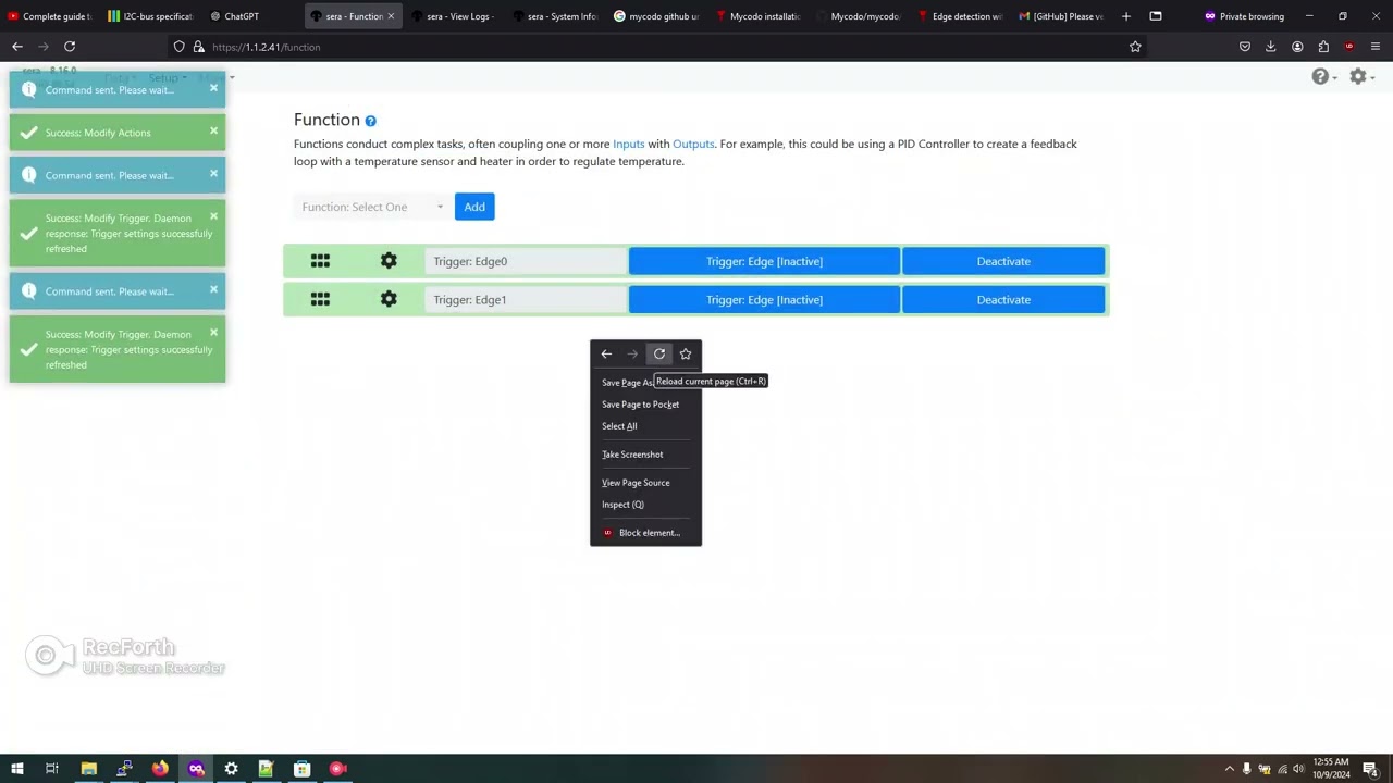

After setting to channel 0 and 1, you pressed the Save button at the top of the Input Config?
Are there any errors in the Web Log?
Is channel 15 actually selected when you inspect the HTML form select input?
You’ll have to just add a lot of logging lines to determine why it’s behaving as it is when you have all channels in one Input. There’s no good reason why all channels can’t be in one input.
Yes, I made a short video to show that for example refreshing the webpage will change the previously set channel to channel 15…
