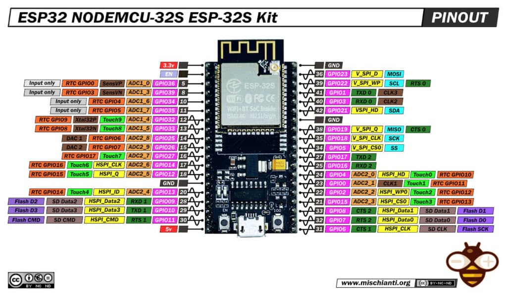

Many of the sensors listed in the Mycodo documentation are also compatible with Tasmota firmware for the inexpensive ESP-32 dev-kit boards like this one…
You can build wireless sensor clusters by connecting your sensors to the ESP-32’s GPIO pins, run the Tasmota firmware on the ESP32, and use the MQTT protocol to send the sensor data over WiFi to Mycodo.
