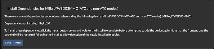

I had to reinstall my setup after SD card corruption… swapped to external HDD now. Upon installing the newest mycodo version on a freshly setup system. I keep entering a loop during dependcy installation for the Mijia input.
libglib2.0 is installed but keeps popping up as not installed.

Start dependency installation via UI for input Mijia LYWSD03MMC.
Installation finnishes succesfully but can’t add input due to libglib2.0 being required again.

I’ve tried multiple fresh installs but always ran into the same issue. Also installing the package manually did not help. Am I missing anything hidden in the logs? Any help highly appreciated. Thanks
Upgrade to master and see if that fixes the issue.
Potential fix committed:
Yup, that import change did the trick! Cheers
