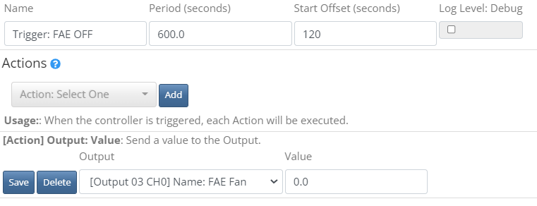

A little feedback on how I solved it.
Created 2 trigger:timer(duration)functions, one for FAE ON and one for FAE OFF and an enable and dissable FAE function
FAE ON was set like this
FAE OFF was set like this
dissable FAE function deactivates the triggers and sets my fanspeed 0-10V to 0V
enable FAE function enables both triggers.
This results in a 6 times per hour FAE that lasts 2 minutes.
Thanks for helping out.
