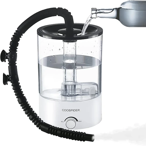

There are many small consumer humidifiers on the market. If you look specifically for terrarium/reptile humidifiers, you can find some that have an integrated hose that will allow you to more easily plumb into your chamber. For example:

However, for your use-case, I would really recommend a humidifier like Kyle posted… one with a hose so that the unit can easily be setup outside the refrigerator and refilled easily without having to open the frige.

That being said, I do like the idea of having it outside of the fridge and will likely move in that direction as Kyle suggested.
