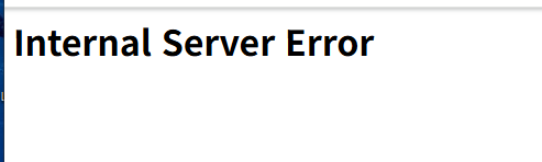

Export Measurement Data as CSV is internal server error?

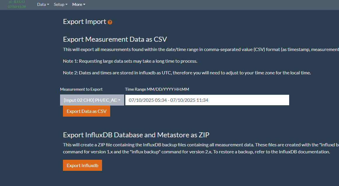

Excluding ph and ec in Export Measurement Data as CSV, the measurement records are internal server errors. Only ph and ec measurement records are saved as csv files
