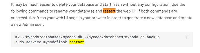

Update -
Well I can’t get into the webgui and i’m guessing its due to these changes but I can save the config as a backup then revert to prove it out.
mv ~/Mycodo/databases/mycodo.db ~/Mycodo/databases/mycodo.db.backup
sudo service mycodoflask restart
Looks like this kicked off some different services but the webpage still doesn’t load.
Performed a reboot…
Error 502: Bad Gateway Error
persisted after a reboot.
