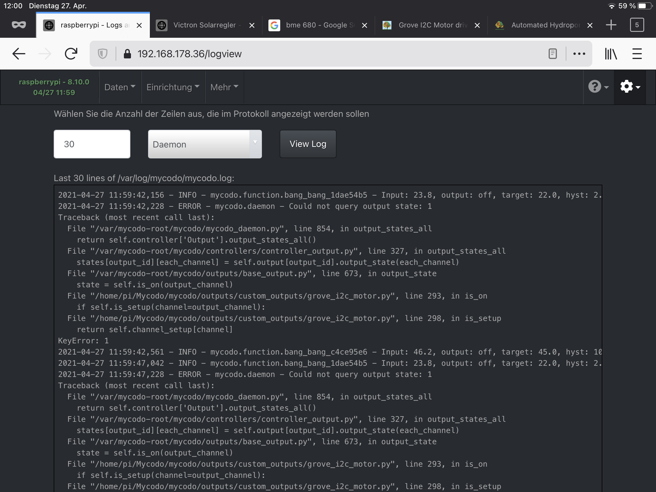

Today i‘ve conected the 1.0 grove motor driver, found them in i2c, load the 1.0 driver Testmodul 06, but only errors appear when i try to switch on or off.I dont know what to do it, because i dont have the knowledge like you
I need some help to get it running.
Could you expand the output, so we can see your settings:)
The only setting i have done is the correct i2c adress in the field, all other settings are unchanged,
Nevermind. I get the same error. Kyle have to look into it.
You can use the 05 version for now, if you dont need the pulsing output.
@kyle When using the manual buttons, I guess no amount is send and as such it looks like amount = None, which it apparently doesn’t like:) You can delete the rotation thingy all together as it is not used as of now. Alternatively you have to change the output function to flip command to 0x03 which is run in reverse.
