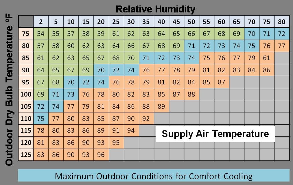

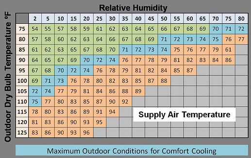

Another option might be to use one of those “as-seen-on-tv” “mini personal cooling fan”… which is basically nothing more than a mini evaporative cooler… running a small evaporative cooler can drop tempeatures as much as 10F or more depending on the ambient temp and relative humidity of the supply-side air in the room… only drawback is you have to keep filling it with distilled water only, or else the cooling pads become caked with mineral residue and can no longer cool efficiently and need to be replaced much more often.
