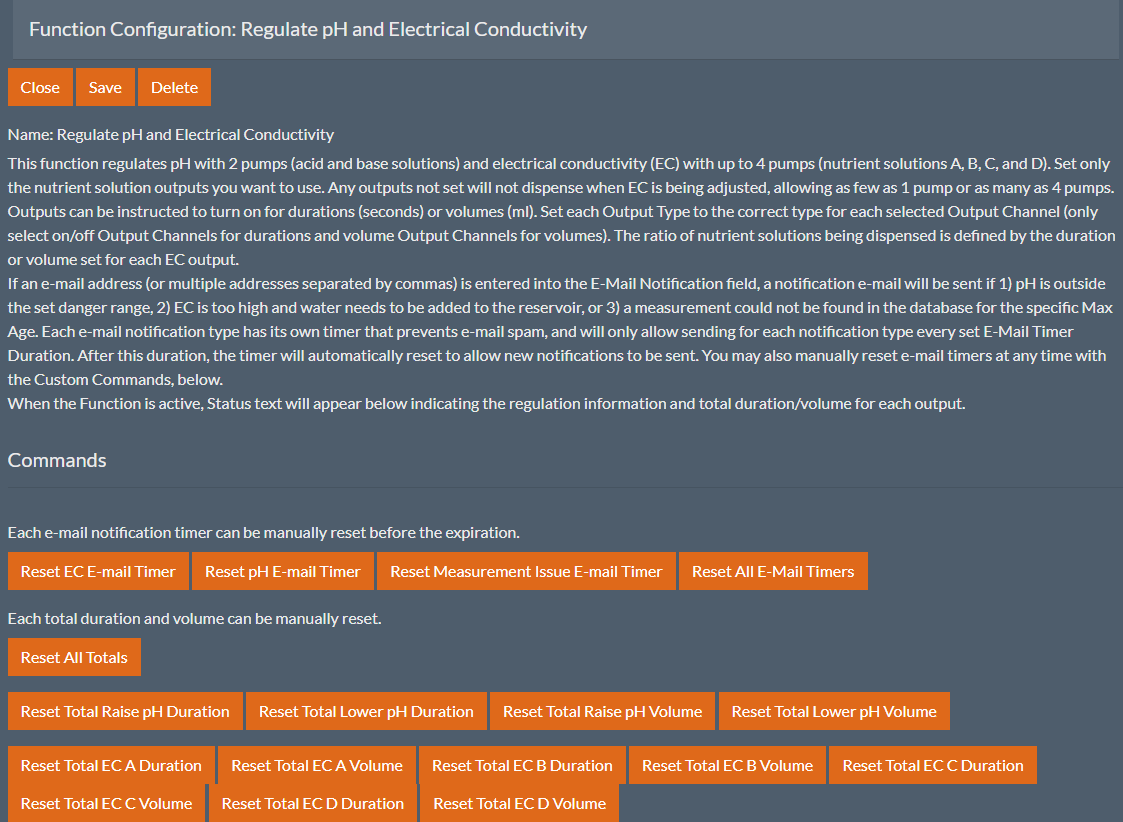

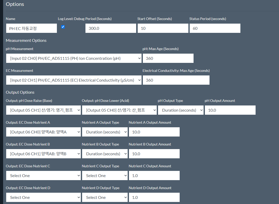

In Regulate pH and Electrical Conductivity, if ph and ec are out of acceptable range, which one will be corrected first, ph or ec?

EC will always be adjusted first, as adding nutrients will change the pH. Once EC is within the acceptable range, pH will be adjusted.
