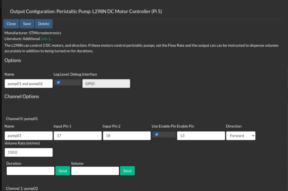

Hi, it works fine on Pi 5, but there is missing the option “Enable Pin Duty Cycle” for the speed control.
This output doesn’t use PWM, so there shouldn’t be a duty cycle option.
If you have a reliable method to conduct PWM on a Pi 5 pin via Python, then PWM could become an option.
