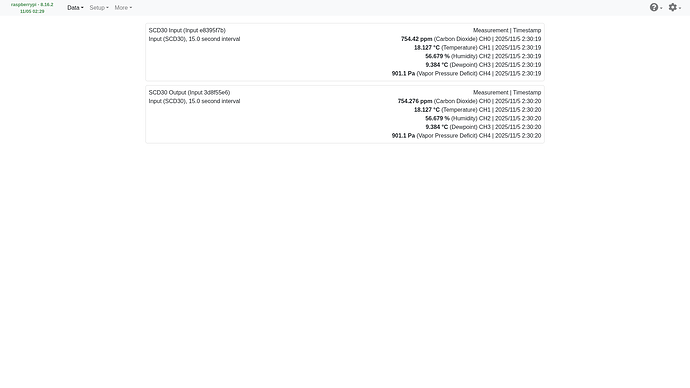

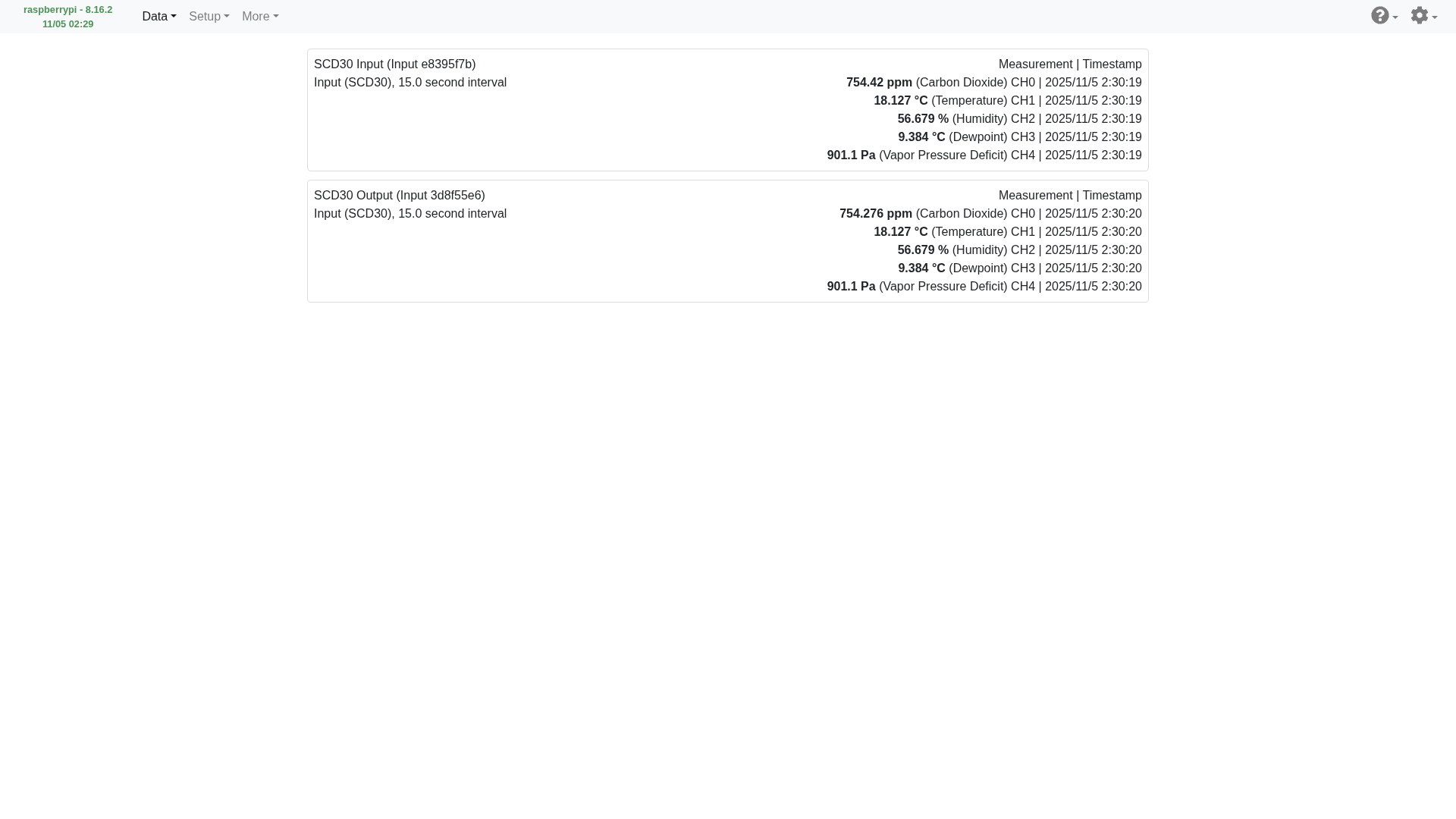

I have installed a multiplexer to read two SCD30 sensors.
Currently the two sensors return the same values, which is sensor 1.
I have individually tested each sensor, then tested the multiplexer on its own, then tested each sensor attached to the multiplexer. I have enabled I2C and then added the dtoverlay to the config file.
I am misunderstanding how to use the multiplexer to select the appropriate bus, and acquire each sensor’s measurement. I have tried many configurations and I am stuck.

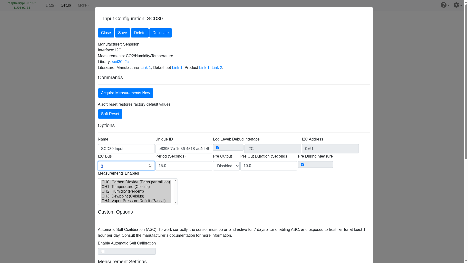

In the last screen shot below, do I add a value to the “I2C Bus” Input for each sensor to return its own value?
Here is what I have:

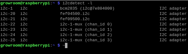

i2cdetect -l

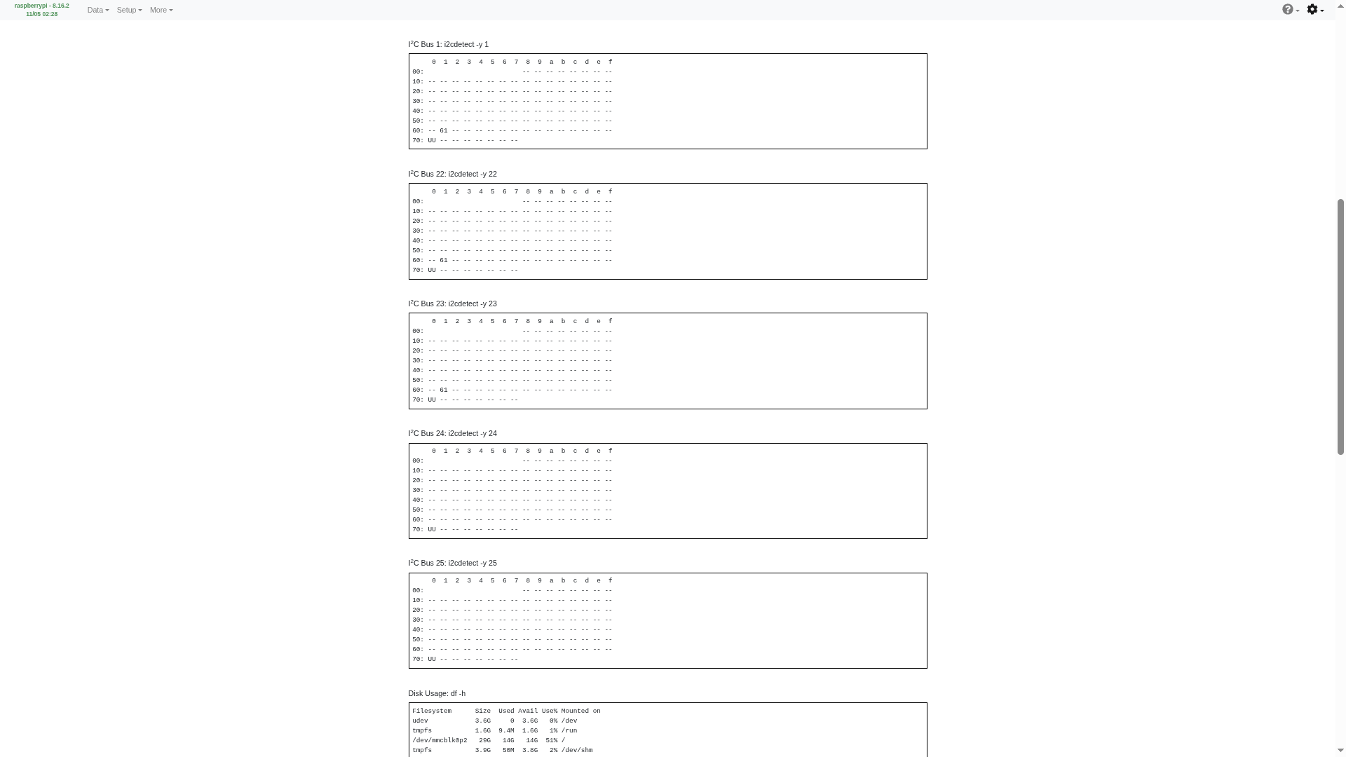

System Information:
Live Measurements:

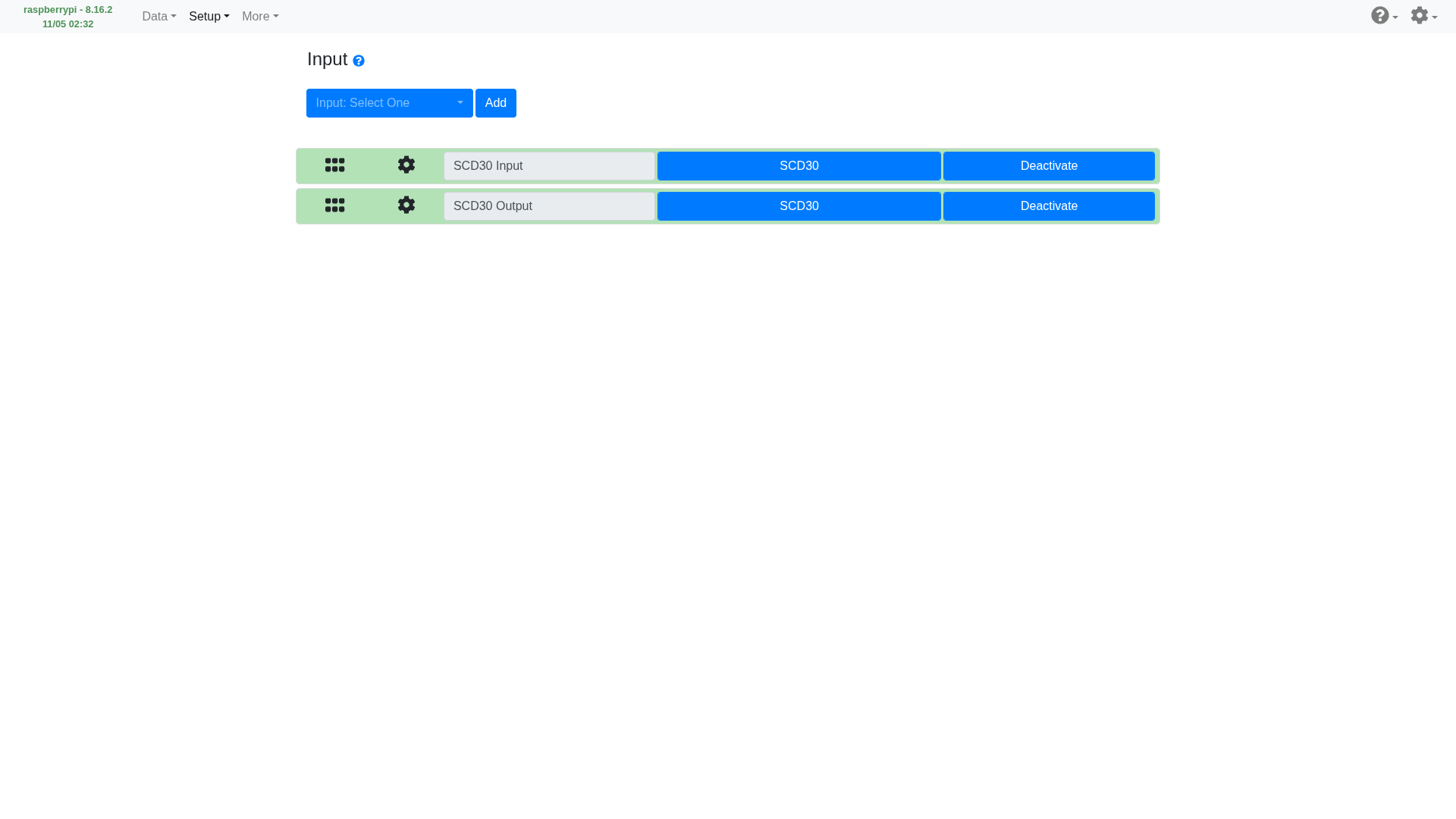

Input Page:
Input Configuration:
The multiplexer will create a new bus for every channel of the multiplexer. Therefore, you will need to set the appropriate bus if you want to measure different devices connected to the multiplexer. You will use the same address, since they are now separated onto different busses.
Is this a Pi 5? What is the I2C address of the sensor?
This is a Raspberry Pi 4B (fresh install of Raspberry Pi & Mycodo).
The I2C address of the SCD30 sensor is “0x61”.
From your screenshot, it looks like you would use busses 22 and 23.
This is where my confusion occurs.
I have used bus 22 & 23 for the two sensors and they still display the value of the first sensor, even after a reboot.
Is there a suggestion of what I can do to fix this?

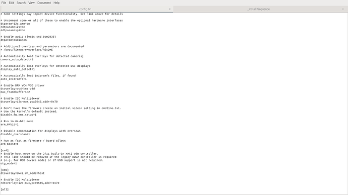

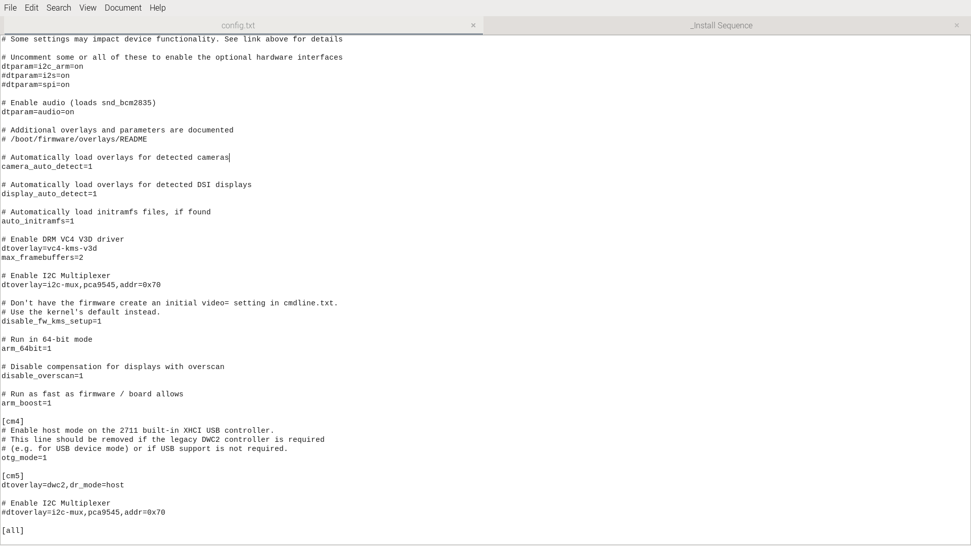

Perhaps the overlay you’re using isn’t working properly. This can occur with kernel updates if the overlay hasn’t also been updated. Where did you get the overlay and does it have documentation for how to use it?
This is where I coped and pasted the dtoverlay from.
The code for the kernel driver is: dtoverlay=i2c-mux,pca9545,addr=0x70 .
I recall that when I first copied and pasted the code for the kernel driver, it was at the end/bottom of the config file and the multiplexer did not appear in the Mycodo System Information.
When I copied and pasted the code for the kernel driver higher up in the config file, the multiplexer did appear in the Mycodo System Information.
Here is a screen shot of my config page:
I have returned to this issue today and the error log shows the following:
OSError: [Errno 5] Input/output error
