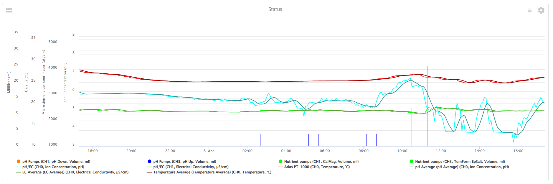

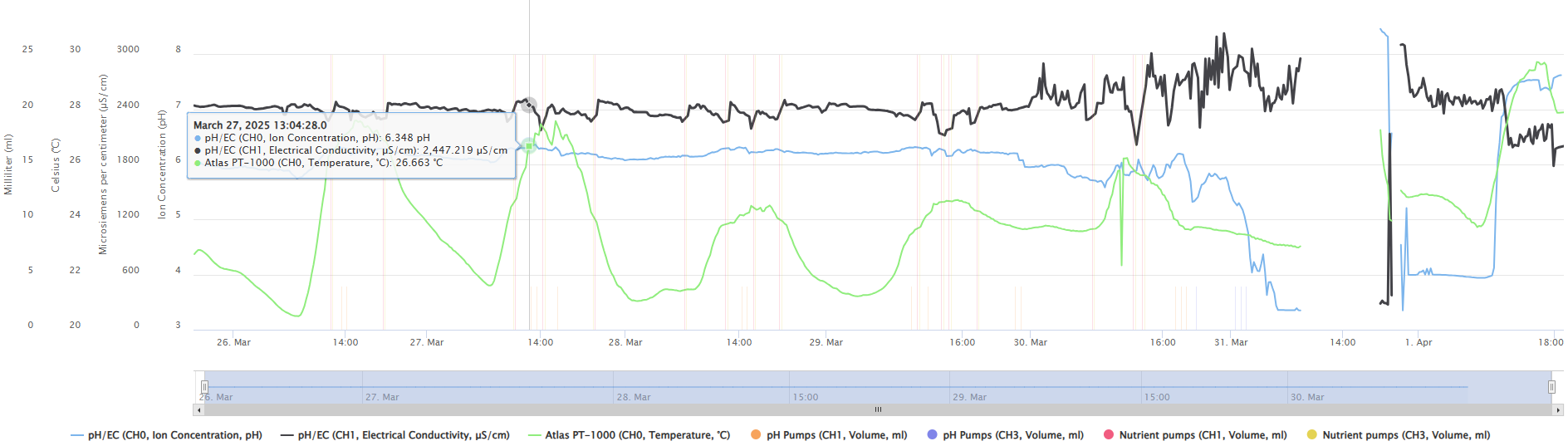

Hi,
My system was operating smoothly for the past couple of months (using DFRobot EC and pH boards with parasitic insulator, Apera instruments EC and pH probe, and Atlas PT-1000 temp probe… all in I2C).
A few nights ago it started going crazy and after rebooting the I2C went offline. Had to disable and re-enable it to start it back up, but it started having some off behavior. See the asynch graph below. Anyone has any idea what this could be? Or any recommendation on what to try? System is outdoors, but it is inside an enclosure protected from the elements.
Pi? Power issue? One failed sensor fouling the others? I’m only running Atlas pH and PT-1000 off my Pi3 with T3 board. I know I’m due to down the system and bring everything indoors to calibrate since my PT-1000 has been inaccurate for months.
I am running a RPi4b. I do not think there was power issues as of late. I am using the rpi power supply, and it is all mounted on a surge protector too. The temp sensor seems to be behaving well, I think the pH/ec sensors are the ones that might be acting up. I had to recalibrate them and restart the pi multiple times until they were back online giving reasonable data…
After a few days, the behavior started again. I purchased an Atlas lab-grade pH probe to see if it is the probe. I will update a few days after it arrives and gets installed

The pH sensor I use from Apera Instruments is ~$40 and has been working just fine. It has been working for more than 6 months without a recalibration. I am happy with that and I think it is well worth not having to add water/nutrients/ph down to the system every 3 days (that’s why I got Mycodo). I found the culprit and there was some root debris that was touching the sensor membrane and throwing everything off. I added a coarse filter on the return to prevent this from happening again.
