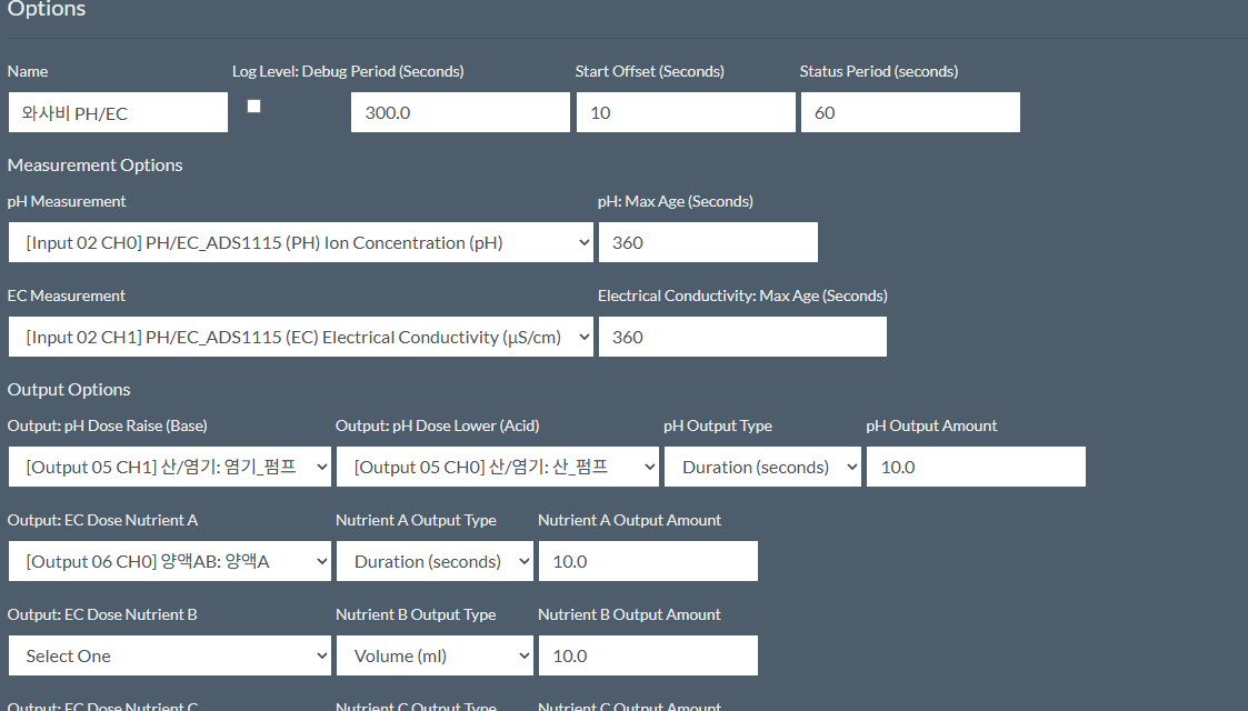

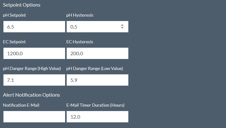

Name: Regulate pH and Electrical Conductivity
In OUTPUT, positive fluid A is operated manually, but the positive fluid A peristaltic pump does not operate when the EC value is less than 1000 in the Regulate pH and Electrical Conductivity of FUNCTION. The peristaltic pump operates when the PH is increased or decreased.
