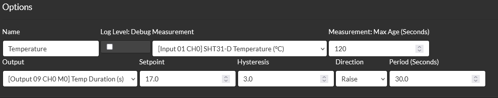

They had the same period of 30 seconds. I now changed them to Input 30 seconds:
and the max age to 120 seconds:

The same period shouldn’t cause an issue. How often did the error occur? And the function could not recover after the error?
I would say once per week. If I turn the output on manually and the value rises over a certain level, the system works fine again. Might the router connection be a problem if there is a delay of some kind? Because I always see the values of my measurements, but sometimes I can’t connect to Mycodo.
It’s important to understand what is actually causing the issue: the input, the output, or the function. This is the first time I’ve heard of the bang bang function not working, with probably years of combined use of it among all the users using it, so I would lean to think there’s an issue elsewhere. But I’m open to the possibility, I would just need to see evidence (relevant log lines) to be able to first be able to replicate the issue, before I would be able to develop a fix. I’ll do a quick review of the relevant code and see if anything looks awry.
