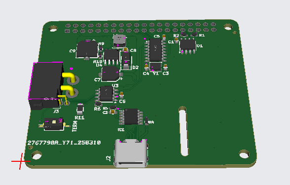

This is test with another seconday board connected to the CANbus. Mycodo is able to read the sensor values from both boards.
As you can see on the seconday board there are two CANbus connectors. This is so you will be able to daisy chain multiple boards to extend the functionality further (if needed).

There are some existing open-hardware can hats for the pi CAN BUS Dual Base V2.1.4 Shield for Raspberry - SG Electronic Systems you may have seen these already
https://www.sg-electronic-systems.com/ecommerce/12-can-bus-shield
